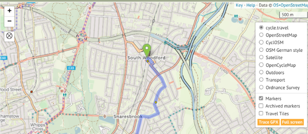

First of all, CT offers a variety of map styles (more to subscribers) on the 'hamburger' menu, top left.  These can help us to plan better. This is the standard CT map showing South Woodford.

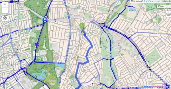

And the CycleOSM version

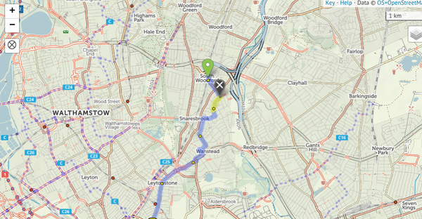

Markers can be added to maps or routes to highlight good or bad features:

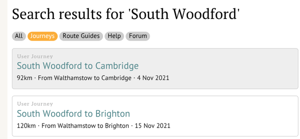

Searching CT (search bar, top right) can help us find other users' routes:
Admittedly, large cities can be complicated (various search terms may be required) and there is no guarantee of quality.

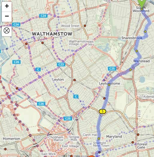

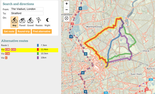

Taking your 'South Woodford to Stratford' non-specific example, this is what CT offers for 'any'

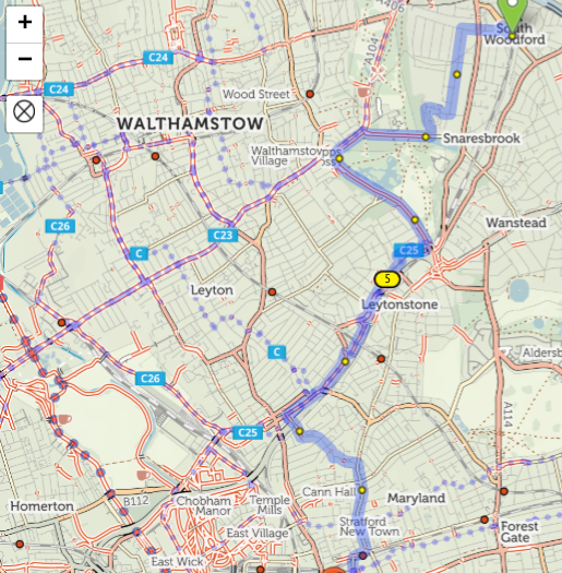

Now, I have no idea if that is a 'good route' but if I manually move the startpoint slightly I get...
We can see that the first half is substantially different. In other words, when planning a relatively short, urban route it's probably worth our while playing around with the obvious parameters (start & finish). For example, I live on a one-way street so I don't plan a route from my front door. I start it from the closest junction and simply walk the 50 meters.
