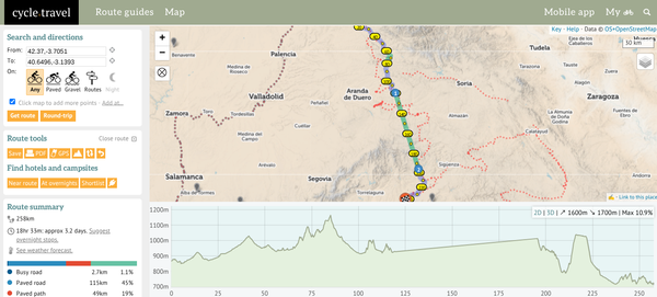

Anyways, there is a simple solution to your request. We can use via points and use the 'Go direct' function between them (to represent your train journeys).

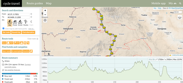

Take this example, Burgos to Guadalajara:
Distance: 301km, Elevation gain 2700m.
I can add viapoints (here chosen randomly, you'd use your start & end train station), then click on the VP, then 'more' then 'go direct to' (next VP).
That section shows up as a straight line with the elevation and distance subtracted from the original
Distance 268km, Elevation gain 1600m. It has the advantage that the 'train' section is pretty obvious.
Obviously, if you decide to cycle that section, then removing the VPs or changing the 'Direct to' function will show the actual route again!
